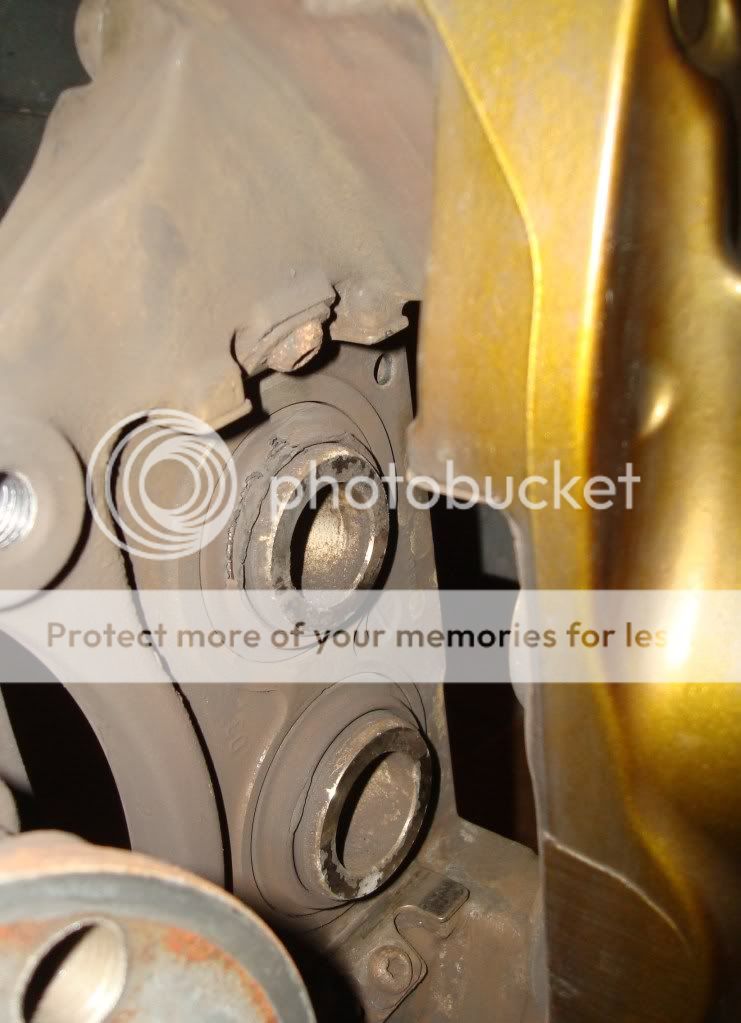

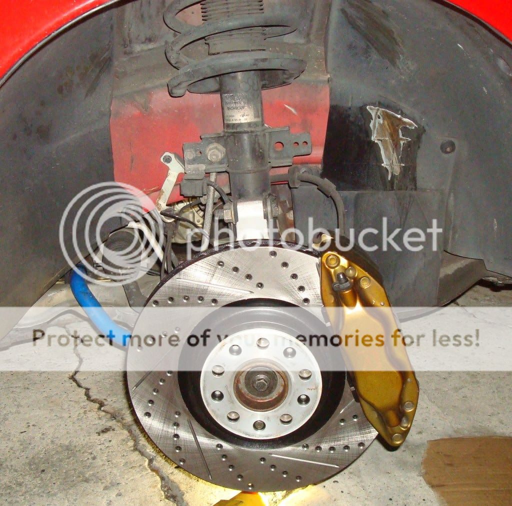

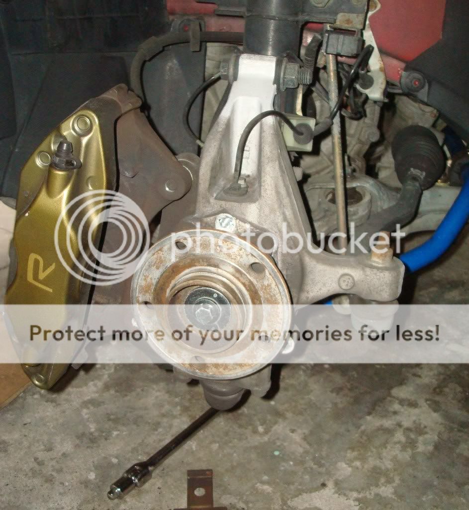

Those are the cracked boots on the extra hot side. The right brake seems to have gotten hotter than the left due to all the hard braking into the turns on a counter clockwise track.
Pistons still move nicely so I know the pistons and seals are ok, just need to replace the dust boots when I have a chance so no crud gets in there to mess anything up.

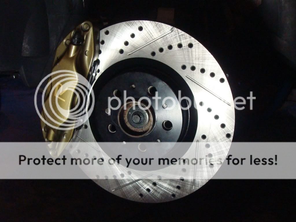

Pedal is a lot stiffer, but I think that has to do with the pistons being shoved all the way back into the caliper. Great feel with the factory (Jurid) pads on the new rotors. Trying to decide if I will do my next track event with factory pads or if I will pop in a set of racing pads when I have some extra hot braking planned.
I did remove the backing plates and will most likely pick me up a set of higher performance pads for track days now.
Will also be using some of my Stealthy sheet metal fabrication magic to create a nice set of air scoops for under the a-arms to redirect some of the under car air to the rotors as well.

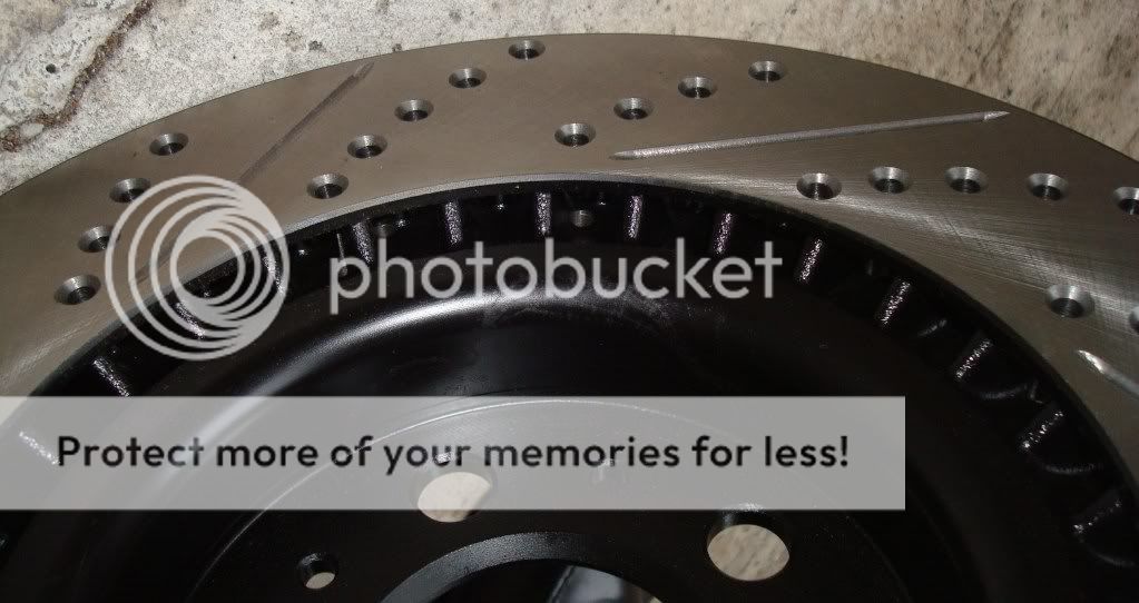

I don't know if anyone has told you this, but cross-drilled/slotted rotors are purely aesthetic and will actually hurt your on-track braking performance. Those look good on the street, but definitely switch to blanks for the track.
Cross drilled rotors may crack under hard braking no matter it was casted with the holes or drilled afterward.
But it will have better cooling efficiency than slotted.
Slotted rotors are kinda best of both worlds.
It has better cooling efficiency than plain rotor but more durable than cross drilled.
Even though plain rotors have slightly more surface area than cross drilled or slotted.
The headsink will kill the braking performance more than the gain on the slightly more surface area.
Also each 1lb lighter on the wheels equals 1 more whp gain not to mention the lighter weight.
J-velocity beat me to it, but the advantages of cross drilling are for both cooling the rotors and pad surfaces, the only downside is stress cracks but usually by the time they get bad enough to be a real concern its time for new rotors anyways.
Slots and crossdrilling do slightly reduce the pad contact area, but big brakes like the brembos have some excess in that area already to where once again the extra cooling factor more than makes up for the slight loss.
If I wasn't planning on regularily tracking my car the cross-drilled rotors would have been a bit excessive, slots would have been good enough for the street and the occasional auto-x.
For those that think the pros don't outweigh the cons, go find me a single set of race car rotors that are not cross-drilled.
Excuses, excuses, excuses. Nascar runs on road courses too, and they NEVER use drilled brakes. The F1 rotor is most definitely not carbon, so what is it? Aluminum?? lol. What would that matter anyway since you think cross drilled rotors are superior. FIA GT cars don't use drilled brakes either. In fact I can think of any sanctioned racing series that has cars with cross drilled rotors.
You're not going to believe me, so give a tech at Stoptech a call and ask them which of their rotor options (drilled, slotted or blank) they recommend for track use.
