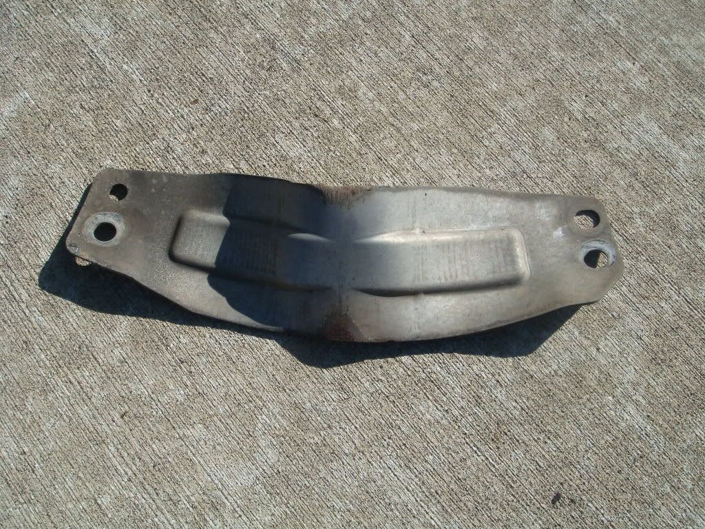

      Eight posts and no one has mentioned the beloved EBD (Exhaust bracket of Death)
      What to look for: Exhaust Bracket of Death (EBD), actually the absence of it. If present, look for evidence of the rear edge of the resonator rubbing the prop shaft. If evidence of rubbing is present, look/feel for evidence of bent prop shaft (e.g., vibration while driving, particularly higher speeds).
      Description: Ridiculous metal stamping located just aft of the resonator. If left in place, it can be bent upward forcing the exhaust resonator to rub against the propeller (drive) shaft and create annoying squealing/rubbing noise. Worse, more expensive damage can occur if said resonator remains permanently in contact with prop shaft, i.e. it can bend the prop shaft which can be very expensive to replace.
      Years: All
      Miles: Any
      Fixes.
      1. Remove it. Re-install using the existing bolts, but add larger washer to keep the heat shield in place.
      2. Optional: replace it with the rain squeal bracket (PN 307422659) pictured here
