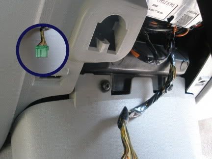

      Step 1 is to unhook the green connector from behind the waterfall then you can pull this panel off from behind the waterfall (really do those in whichever order you prefer). I wrapped a washcloth over the bigger flathead and pryed until I could reach my finger under, then just pull it away. Repeat prying it on the other side.

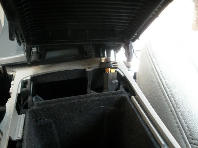

      Step 3 open the armrest and remove the 2 torx screws

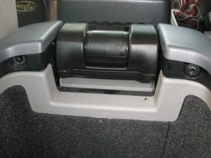

      Step 4 pull the trim (and cupholder cover) just straight up off, only thing connecting it are tabs. Between the armrest and the cupholder area there's a piece which stretches down into the console and takes some wiggling and patience to get out (or back in). Toward the front there's the connector for the 12-V (note: not much slack with this, so be careful)
      Step 5 you have now revealed the front screws! Which is the easiest part of these screws lol

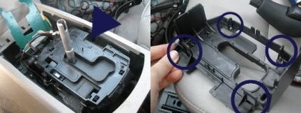

      Step 2 gently pry up the circuit board. Start where indicated, so the other back corner, then just gently lift it off.
      Step 3 remove this piece... start from the passenger's side (as the clips on this side face out where the other clips are facing the front/back - see photo)

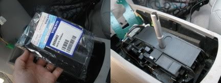

      Step 4 you're there! Pull off the old one and replace with the new one!
