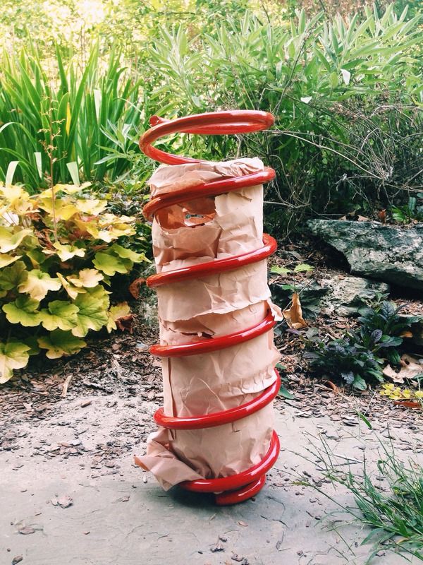

      SPROIINNGGG!!!

      Oooo pretty. Which springs?
      Bad Swede 2" lift. May be a while yet before they go on, but I'm excited nonetheless. They didn't come with noise isolaters this time so I want to see if their is some sort of OEM component that can be used because I recall someone on XC forums mentioning some groaning without them. Also may want to wait til I have new tires and/or wheels sorted as it may look a bit silly lifted on stock size.

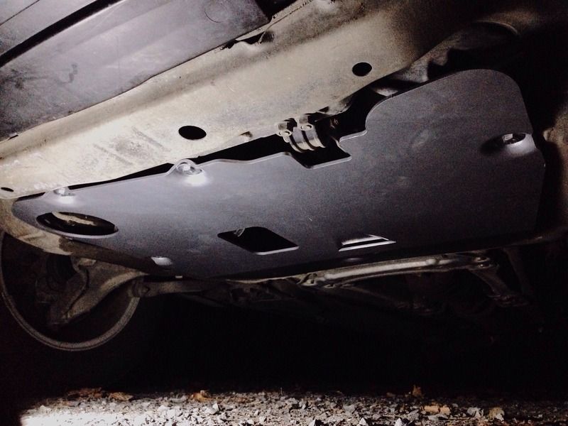

      At last...The Skid Plate Install!
      So I've had the plate for like 6 weeks now, and I just couldn't deal with it not being on the car anymore. Was on tight deadline for a client project that I turned in Tuesday morning, and had not had much time at all for tinkering in the evenings the past couple weeks, so I was happy to jump on it tonight and get it on there. Removing the old "skid plate" was a breeze.I thought the bolts would be more of a problem than they were. I feel like the few times I've gone to wrench on this car I've been surprised by the ease with which bolts loosen. Guess that's what happens when a vehicle is garage kept most of its life. I used to have to dump PB Blaster on my Toyota truck to do anything to it.
      The first trick was figuring out how I was going to support the much more substantial IPD aluminum plate on my own while underneath the car with low clearance in order to line it up. I was able to place a skateboard on its side, which proved to be a nice height to allow the rear of the plate to rest while I put a few bolts up front. Everything was going smoothly and I had three bolts in, so I decided to try and get the back one lined up. It seemed like the bolt was juussstt long enough to reach the hole above. For the life of me, I could NOT get the ****ing thing to thread with it's washer! No washer? It would just reach, but try as I might, when I put the washer back and aimed again, I couldn't get it to bite. This went on for 20 minutes, at which point I got so frustrated I had to take a break to eat and calm down. I searched around and was able to find a washer that seemed the slightest bit thinner, and was a bit smaller in diamteter, but not too small. I went back out there and within a few tries got it threaded. Tightened 'em all down, and boom, Done!
      My impressions of the plate itself are mixed. I worked in architectural fabrication for several years up until recently. I have very high standards for component manufacturing and I was bummed to see that the fit and finish on this was not nearly as nice as the other IPD products i've ordered so far. There were lots of unground jagged edges that could have easily cut me up (one almost did) while I was installing it, and the coating was subpar. I was also disappointed to see that it in fact covers less of the underbelly than the factory splash guard; though I remember reading that so wasn't totally surprised. On the "good" side, it was thicker than I imagined it to be, and it seems like it should protect the things it's meant to quite well. I may take it to my old shop and run some reinforcing angle on the bottom ala theshadow. But I'm gonna run it stock for a while.
