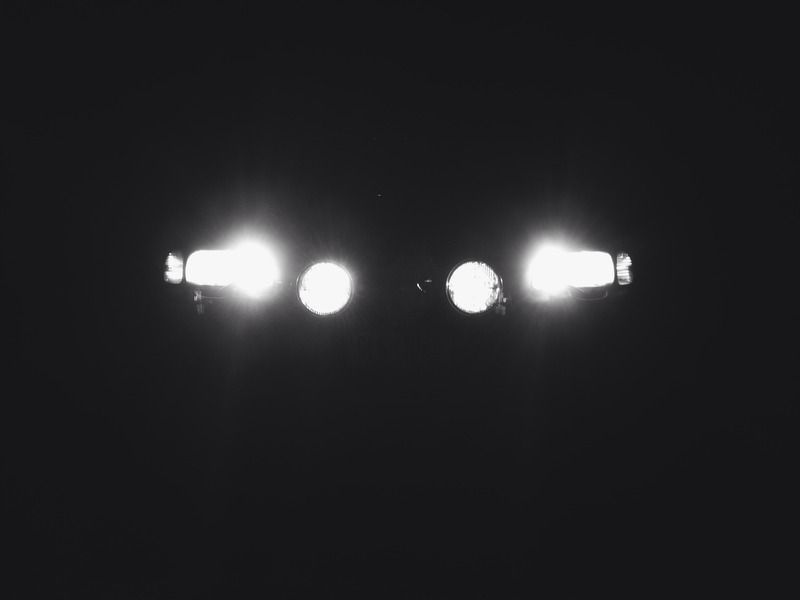

    7. #75
      Member
      Aug 2015
      Hudson Valley, NY
      2,251

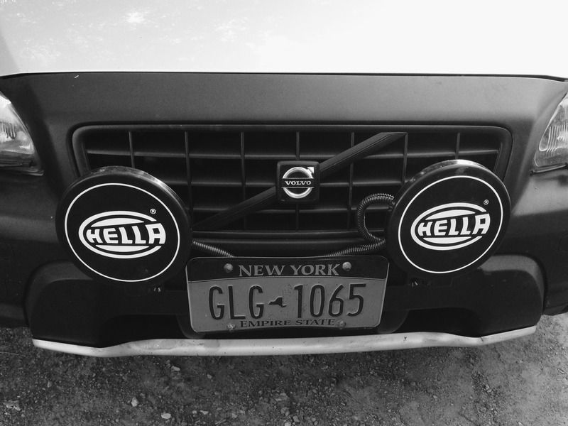

      Hella 500 series black magic driving lights (!!!)
      Very excited about these. Had no idea it was possible and that Tasca stocked an OEM kit for the project. So I banged it out yesterday afternoon. It's the "biggest" project I've taken on yet (laughable for the more experienced) and im psyched I didn't fry the car. This instructional was super helpful: http://www.volvoxc.com/forums/showth...on-Guide/page2
      Here they are:
      Really happy with the way they came out with a few nit-picky exceptions. They are wired into the brights and turn on/off through a OEM switch on the dash that replaced one of my dead switches. Really neat and clean.

      Thanks for the links man. It actually never occurred to me that I could dip my wheels with tires on em like jeep guy did in your example. Seems weird, but that would be a fun, easy way to test on the wheels I have on the vehicle now since I only have that one set rn.
      Here's the link to the parts kit via Tasca: http://www.tascaparts.com/oe-volvo/30772053 . It contains everything you need except for the lights. You could probably fab up something if you're nice with the metalwork and then use the harness and switch kit that comes with the lights for cheaper. But this kit makes it pretty easy and clean, and comes with a switch that pops straight into the dash. Happy with it.

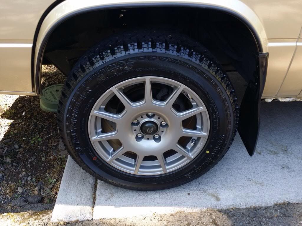

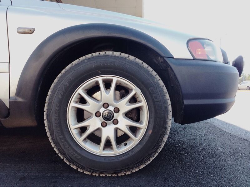

      New Tires, Spacer Considerations, and Thoughts on The Lift
      So after way more internal debate than is warranted for a tire purchase, I made a choice and put new tires on the build on Thurs. I was considering, BFG AT2s, General Grabbers, and Cooper Discoverer AT3s. In addition to the Characteristics of the tires themselves, I also had to consider what sizes were available. On an xc70 w/ 16" rims without body mods, the largest tire you can fit is a 225/70r16. BFGs and the coopers were both available in that size, while Grabbers were not. Grabbers are available in 215/70r16, as are the coopers.
      I read a **** ton of reviews on different sites and forums and went with the Coopers. I was stuck trying to decide on size, and after some back and forth chose the smaller 215/70r16 which is same width as stock, but about an inch taller. I liked the extra width of the 225s, but found the way they stuffed the rest well completely both aesthetically and functionally problematic. From pics I saw you cant even fit a finger between the wheel and front-rear fender liner. That seems stupid to me.
      So here they are mounted and aligned fresh out the shop:
      Rear
      Front
      Tread
      Full
      To give you an idea of rear clearance at this size
      I think the diameter is pretty much dead on perfect for an XC with no suspension mods. Fills the wells with just the right ratio without feeling too cramped. Whereas BFGs and Grabbers look like puffy treaded donuts, these have a slightly sleeker "buzz saw" appearance to them which I think works nicely with the overall direction of my build. However, opting for a size down means I don't get the added width of the 225s which is unfortunate. The rear wheel profile still has the terrible "sunken in" appearance that irks me. The fronts are about 10mm off perfect.
      So here's my question. I bought a set of 15mm spacers. Should I run those only in rear and potentially increase underrsteer on an already understeery car? Or should i just sell these and go with even 25mm kits in front and rear to max out the stance without affecting the track ratio?
      And finally, the lift. I see what IPD Ken was talking about when he said this:

    23. #91
      Looks so badass. I like where this is going
      As for the spacers, I wouldn't stress about running the different widths in the back. I doubt you'll notice a difference in handling but it'll look awesome
    24. #92

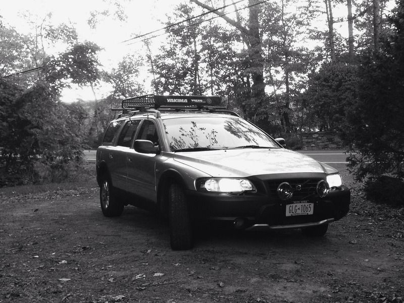

      Thanks Dudes!
      After some more spirited dirt and gravel driving today, I'm very happy with my choice thus far. But I can't really make a call on the tires until they've seen a few thousand miles and plenty of mud, rain, sleet, snow, ice etc. Also gotta run a couple of tanks of gas thru to get an idea of how badly they impact fuel economy. The roof basket took me down a notch, though not as much as I expected based on other people's complaints.
      Hella grills for my driving lights came in too. They were supposed to come with the lights--or so I thought--but I guess they were from a different Amazon seller
      Placed an order for the 25mm kit for the rear. When that comes in I'll be doing the 15mms up front. Won't be flush in the rear but it's as good as I can get at this tire size without a new wheel set. In hoping it makes a difference visually.

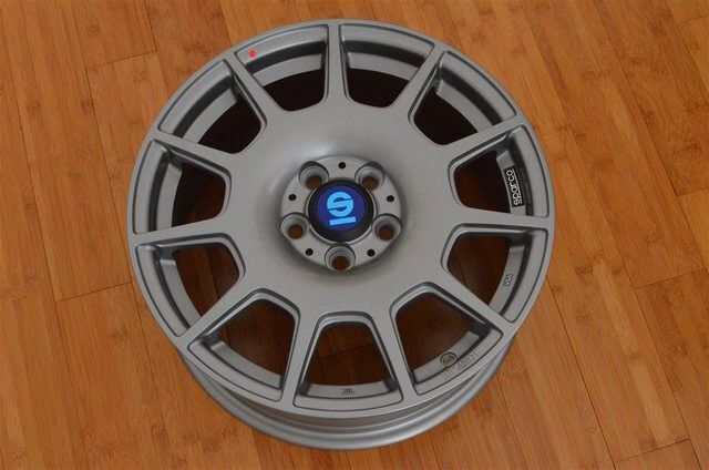

      So I thought I had this figured out. I was basically going to just copy the IPD build and powdercoat some OEMs; most likely tellus, but lately that idea hasn't been sitting so well with me. A) while the IPD build project is my inspiration here, I'm not trying to follow it to a T. And B) I think tellus are an ok looking wheel, but that's about it. Their mag-like silhouette seems like a kind of obvious choice for the "off-road look" but maybe it's too obvious.
      So I dug back in my browser history from several months ago when I was contemplating a second car purchase (still am) and was looking at cool **** I could do to a Subaru. I found a bunch of great gravel wheels that were exciting and Good looking, but when i started the XC project in earnest, I assumed none of them would work. But after watching a bunch of rad old Volvo rally videos this past week, as well as discovering some choice new gravel roads to rip up myself, I thought it might be cool to see if one of those rally-inspired wheels could fit the XC.
      The Sparco Terra is that wheel. It is available in our bolt pattern, but would require hub-centric rings. I've never seen anything quite like them on an XC, and with the tires im running and the overal aesthetic direction of the build I think they might be a perfect--if not obviously so--fit. I'd get the light grey ones with the option to paint later if the color didn't do it for me. let me know what you dudes think. They're on sale right now on tirerack and I'm thinking about making a move.
      Sparco Terra 16"
      On a VW camper van
      On a Subaru

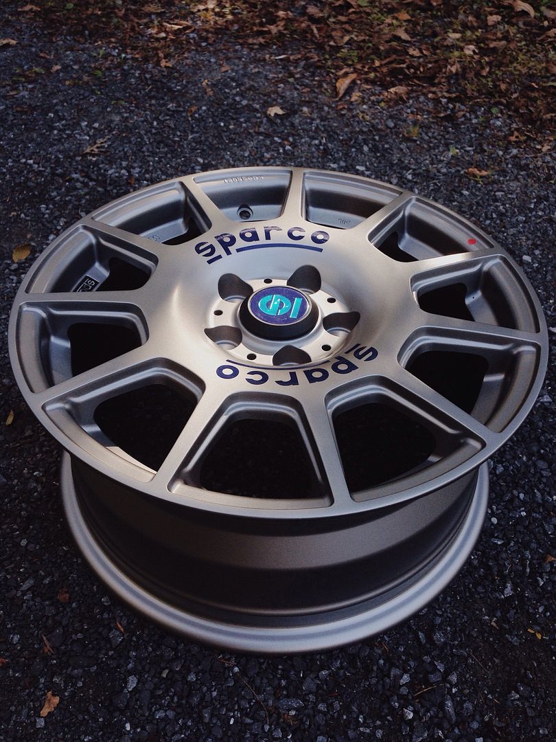

      Wheels came today. Ordered Saturday night from tire rack. Arrived today. Super quick. A real live human even called to ask if I meant to order extra center caps since the wheels came with them (I did); very impressive! They look perfect, and will look even better once debadged and with new black center caps.
      Gravel wheels on....gravel
      Rim detail
      My Patented "real-life-photoshop" technique ;-) (don't mind the wrench box and cardboard shim)
      Just waiting for my 25mm rear spacers to come in and I'll be getting them mounted up. I like that they are something a bit different for the XC without screaming "aftermarket." the grey is a little darker and less shiny than the stock alloys which is just right for me. Black is tempting, but I'm gonna run em as is for a while first before powder or dip.
      Hope to have them on before the weekend if my schedule cooperates.
