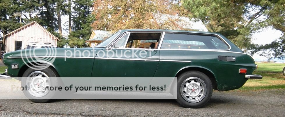

      Here is my stock "Before" stance:

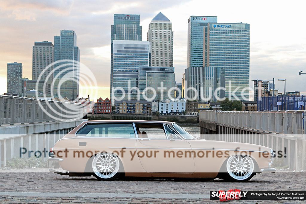

      Okay, and to let the cat out of the bag, here is an example that might be my target, if I can figure out how to keep the exhaust from scraping off...I think airbags might be the key.
      Does anyone know this car and suspension spec?

      I am not sure about that car but if you are looking for a Ridetech Air Pod assembly I have one. I purchased it for a Mustang project I did but didn't end up using it. PM me if you want more info.

      regarding the ES you have pictured, there is a bit more reference about owner and suspension spec on the source:
      http://www.superfly-autos.com/featur...-volvo-1800es/

      Swedeiron, Do you have picks of your wheels with stock springs in place?

      Just to finish this post, I thought I should share the results I ended up with. Wheels are 17"x 7.5" from a Volvo S60. Tires are 205/50/17 which end up matching the stock diameter almost exactly. Springs are 40mm from Classicswede.

      This belongs to one of my customers and was doen a couple of years ago. I made new suspension arms for it and he had the air ride kit fitted. There are more photos of it on my FB page
      Have to say your looks right on the 40mm springs
