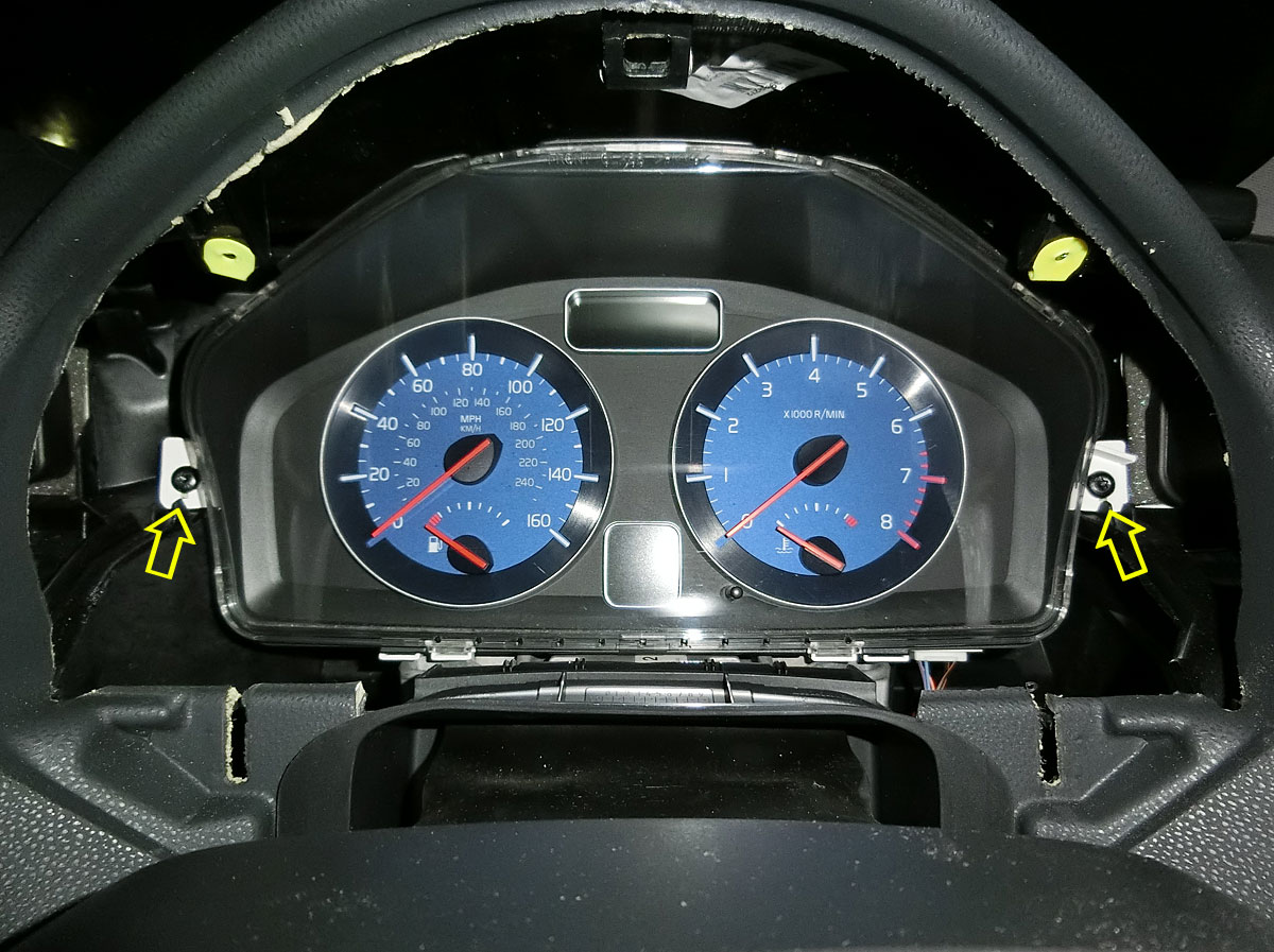

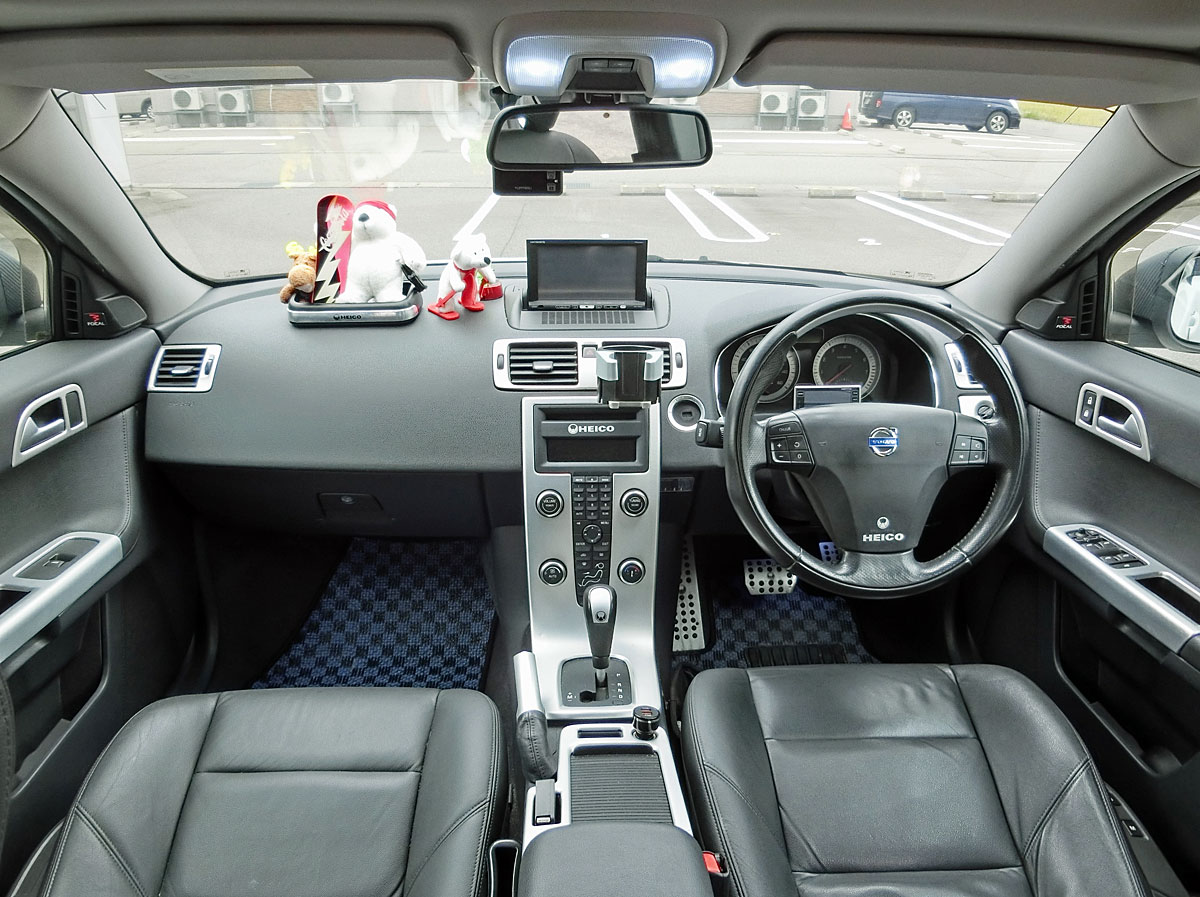

      2012 US C70 T5 Instrument Cluster, Installation
      2012 US C70 T5 Instrument DIM Speedometer(ebay.com)
      Used “Good condition with normal wear; 55k miles” US $225.00
      The simple installation that I only replace.
      Software unnecessary. ℉→℃ / MPH→km/h ,Automatic conversion. Indication is English.
      Illumination(White LED)
      A MPH and km/h writing together are cool.
      A silver ring rises and is cool
      Silva interior completion
      The last style
      Silver plating slim moulding & Heico Hairline sticker,Installation

      Before
      US 2009 VOLVO S40 SPEEDOMETER CLUSTER MPH R-DESIGN/USED(ebay.com)

      Where did you buy the RTI navigation screen like that?

      My unit was $65 shipped on eBay. Before shabbat started the other day I swapped the dials, backdrop, and needles over to my C30. Looks good, but do have to get the speedo gauge set right. Everything else is spot on. I didn't get any pics... It was actually really easy and the needles are tougher than they look/feel.

      So, how does setting the clock work since you only have the mileage reset button? The clock adjustment peg is gone from the 08+ cluster

      You know... I thought the one peg served as both... Spin side to side for clock and PUSH for reset.... could be wrong though. Ill check the peg tonight to see if it does that.

      This. Also, additionally, on newer models you set the clock through the radio interface. If the reset button is grooved you can set the clock that way. It doesn't look like you can set the clock on this unit by itself.

      No because the software is different. Best thing to do in this case is to swap the dials, surrounds, and needles over. It's what I did, even though I can set the clock in the way I mentioned. Seen here (R-Design to C70 part swap): https://goo.gl/photos/cnApeYjRfWpjzmex7

      If you want to do it correctly you have to get a cluster with less mileage than what's on the ECU, otherwise the ECU will update to what it says on the cluster. This doesn't work the other way around - the ECU will always take the greater of two values between the cluster and itself.
      With a lower mileage cluster the ECU won't update and then you can safely get the mileage set though VIDA. I don't know how much a dealer would charge for this or if it's a standard feature in VIDA (it might be).
