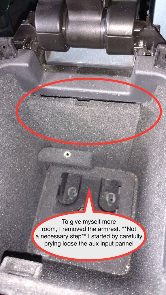

      I removed the armrest top for some extra working space, and to ensure I didn't damage it in any way. In hindsight, I don't think this step is necessary, but here are pictures anyways. I started by prying the Aux input panel out.
      Step 6:

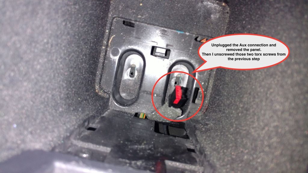

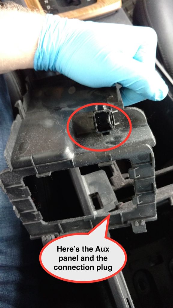

      Then I unplugged the aux port from it's connector. It's just a standard clip.
      Step 7:

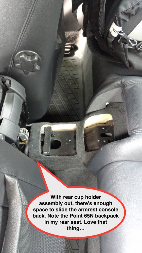

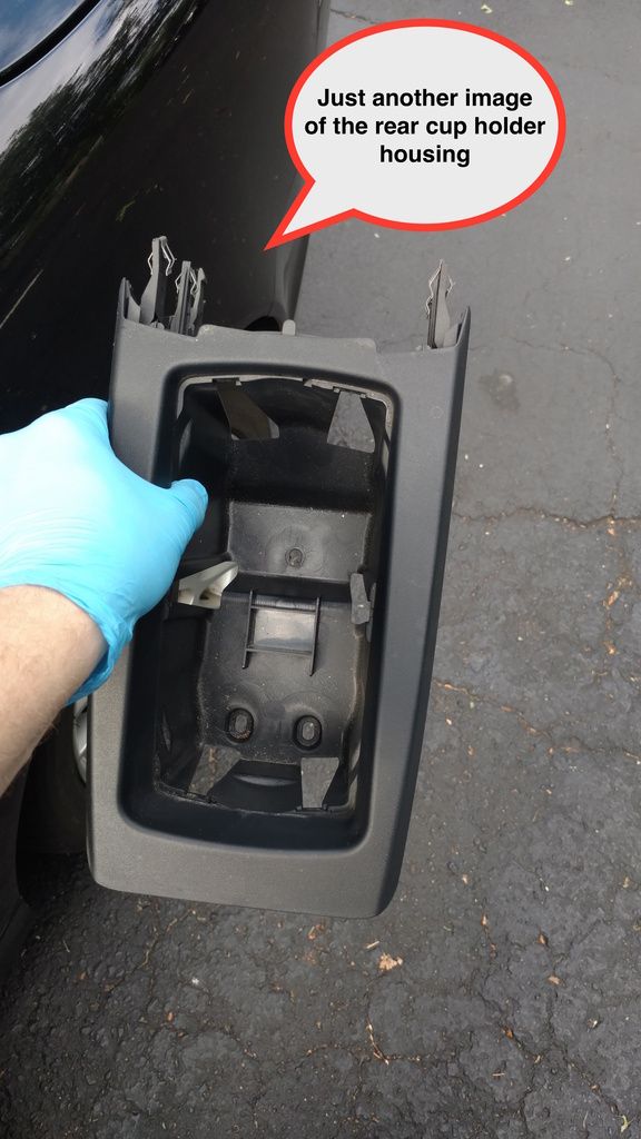

      Pry out around the edges of the rear cup holder to lift it out (the blind is part of the rear cup holder assembly and does not come out separately).
      Inside the rear cup holder housing, there are 3 - 8mm bolts that need to be removed.
      Step 8:

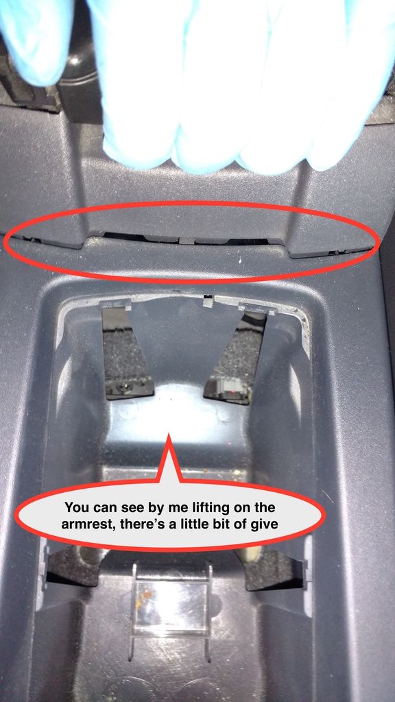

      This is the hardest step. You need to remove the rear cup holder housing. It connects to the armrest console with 6 clips. The two clips at the top, are angled upwards. So when you're removing this, you really have to keep in mind that you will need to raise the armrest console up, and pull the rear cup holder housing downward and back away from the armrest console, to get it out. You can also use one of your pry tools to help you release the clips.
      It was a BEAR to get out. It will come out, but it will not be easy. This is where moving that other front seat far forward will come in handy, so you can more easily reach the rear cup holder housing.
      Please just be very very careful doing this, so that you don't snap any clips, or damage anything up near the waterfall console.
      note: I suppose you could remove the rear seats to make this a little bit easier, if you wanted to go that route

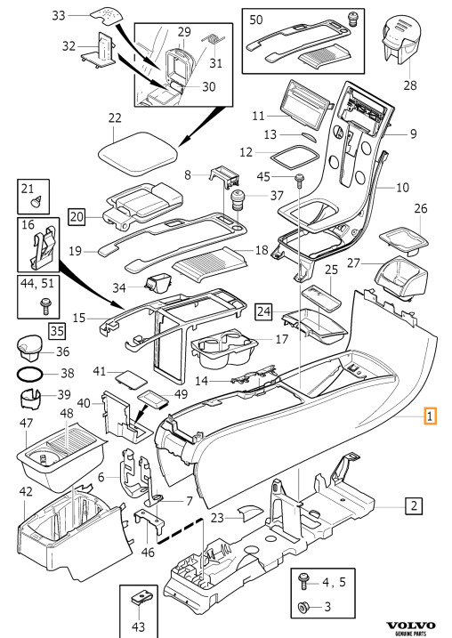

      Also, I went ahead and included a parts diagram, just in case anyone finds it useful, just call up Volvo and ask what part number "X" is.
