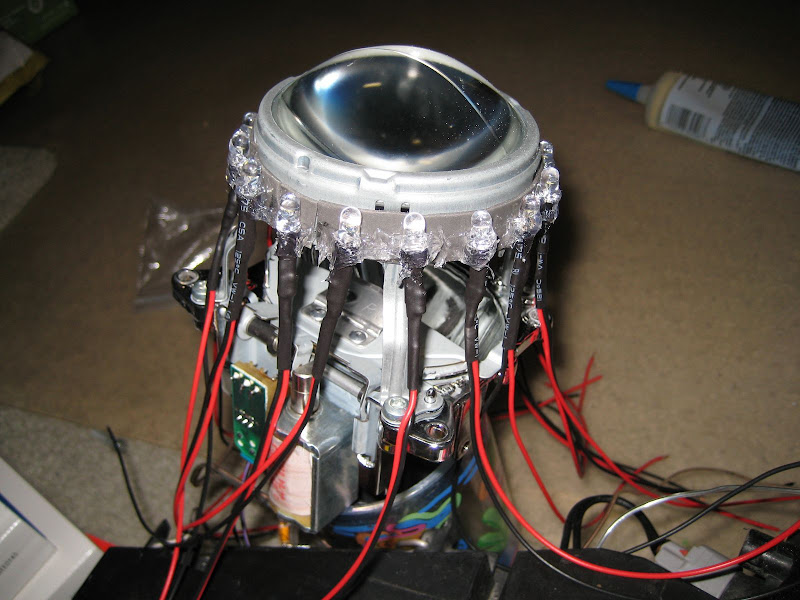

Also, how did you mount them in there? Did you use glue or double sided adhesive, like 3M? I wouldn't think it could handle the heat in there, but I may be wrong.

S40T5Lover I did just use 3M double sided tape. You can see it in the pics. I don't think heat would be a problem... I hope not. I haven't turned my HID yet. To get the wires through the grommet, I popped the grommit off. Then I taped the new wires to the existing wire and pulled it through. Sorry tmtalpey, a little misunderstanding. I didn't disable anything. My DRL is updated to stay off. bopmychimbeech Haha, funny. I usually just go down to Palacios when there is some kind of religious event. My car's not fast enough. Sis in law just hasn't been in cars with aggressive drivers. Hopefully the intercooler and future downpipe will fix that.

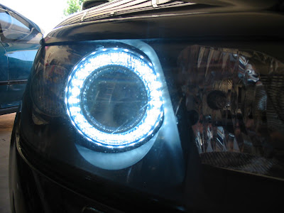

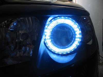

Just an update. I ordered the 48 LED from ebay and cut them to length. I have different problem now. The colors don't match. The one on the passenger side has a greener tint. I think the light was brighter when I tested it. So heads up to anyone thinking of this mod.
2005 Black S40 T5 Geartronic | Premium | Dynamic Trim | Xenon BSR Stage 3 | ATP Downpipe | Bell Intercooler | EuroSport catback | AMSOil cone | Eibach Springs | Centerline RPM Hers: 2008 Cosmic White C30 2.0
zerocover
Swedespeed Member
Offline
749 posts
Fairview NJ
» | 12:15 PM 5-18-2008 | |
Link to ebay product? Try using an orange LED see if it comes out white after the lens.

I was inspired

WoW, Barry. I like that.| Quote, originally posted by volvoNB » | | Just an update. I ordered the 48 LED from ebay and cut them to length. I have different problem now. The colors don't match. The one on the passenger side has a greener tint. I think the light was brighter when I tested it. So heads up to anyone thinking of this mod. |

Second that  How'd you affix the led's to the housing?

That looks like a prior year model S40. How does it look in the daytime.
