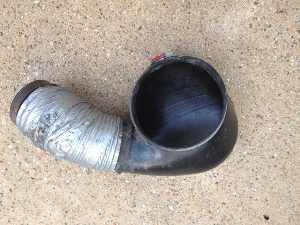

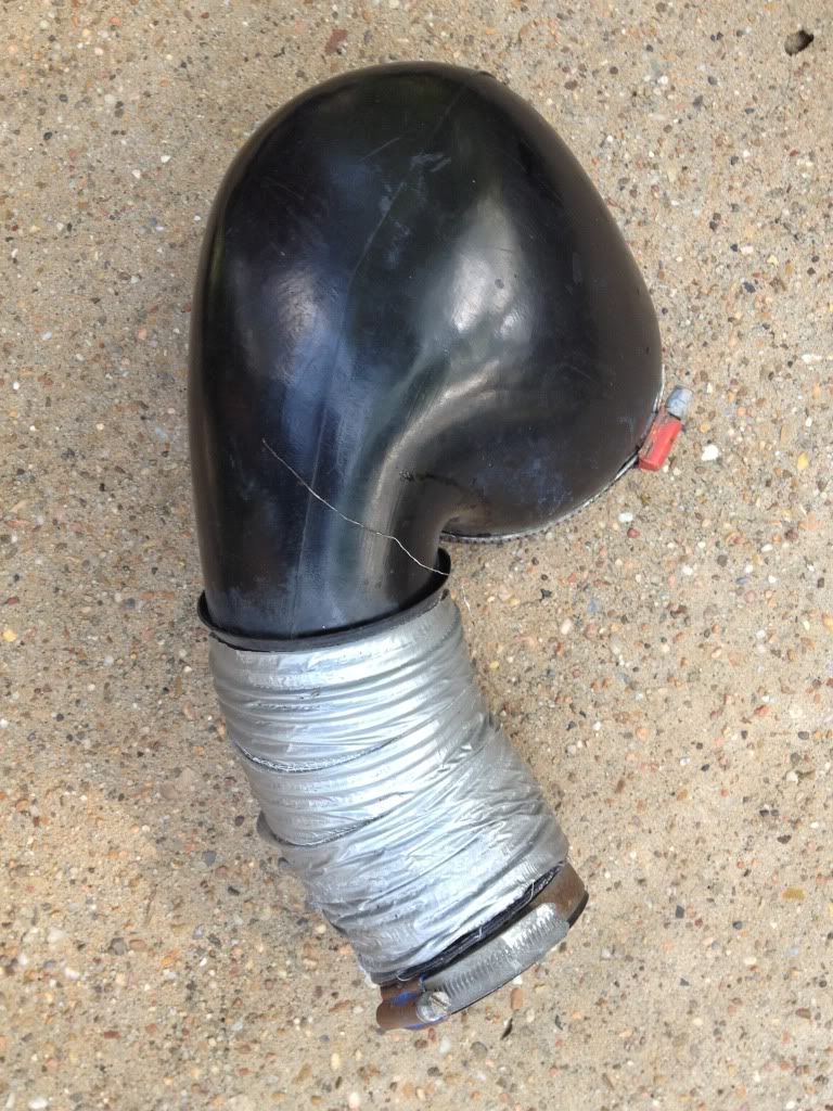

      I also need a new air cleaner to air intake hose - I think it comes attached to the air cleaner cover.

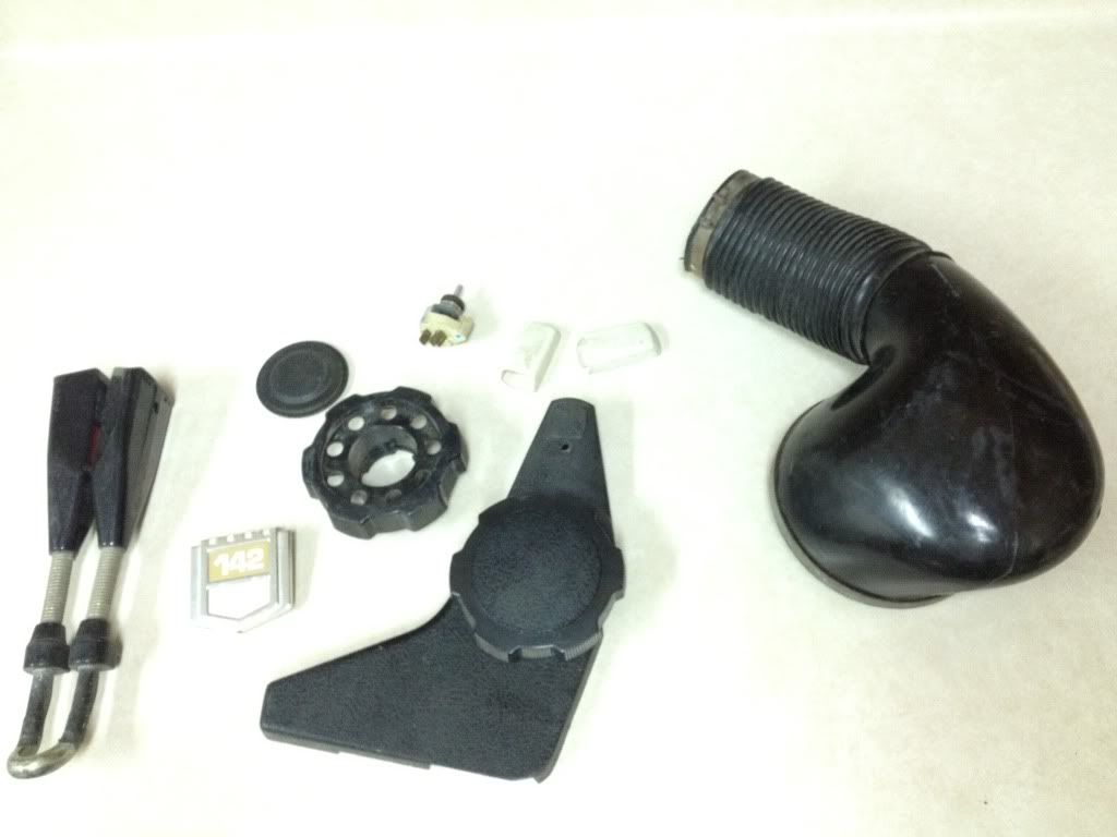

      Here you go!
