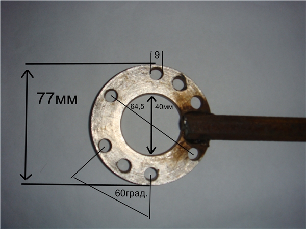

      Attempt #3 & 4: Fail
      Cause: Flange nut cannot be removed with typical tool.
      Went at this agian then brought it to my mechanic who also had trouble. Trying both an impact gun and a two foot breaker bar, using a strap wrench as a counter hold a soaking it with tons of penetrating oil (even though it's not that rusty), and the damn thing wouldn't loose. I'm reluctant to try heat but may go that route if option 3 doesn't work. My mechanic is going to pick-up the Volvo counter hold and will try agian on Monday. He will also be swapping in the new valve body and servicing the front CV while it's in. Time being what it is I can't dedicate any more towards this at this time of year, and not having AWD is starting to get to me. Has be quite damp around here recently, and due to my driving habits, I'm finding that I'm spinning the tires too often from a stop.

    29. #167
      if you have a welder, weld pipe to flat plate cut into "U" shape that catches the flange holes. Wedge against the ground. I guess if you don't have a welder you could just use a long piece of flat stock and drill two holes to catch the flange.
      that's how I remove axle yokes.
    30. #168
      Member Antherzoll's Avatar
      Dec 2013
      Toronto
      4,960
      Quote Originally Posted by nsjames View Post
      Issue i can see with that is the vibration damper around the flange protrudes about 1/2". Tried to adapt something similar but bolts would be too long and would just bend with the torque. What I feel is needed and the Volvo tool will accomplish is a counter hold that clears the vibration damper and mates to the flange directly while providing access to the flange nut.
      Here is one persons DIY from a VW forum.
      2005 XC70 Crystal Green | Hilton | 16T | Bad Swede | 145k mi
    31. #169
      DIY flange tool +impact takes that right off.
      I guess I forget that most people haven't made the investment and take 500 ft lbs of impact driver for granted.
    32. #170
      Dec 2013
      Toronto
      4,960
      I agree, it's the strap wrench around the vibration damper that was dampening the blows from the impact driver, but most that I've heard from that use this method have had success.
