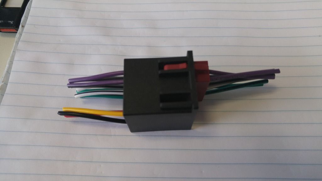

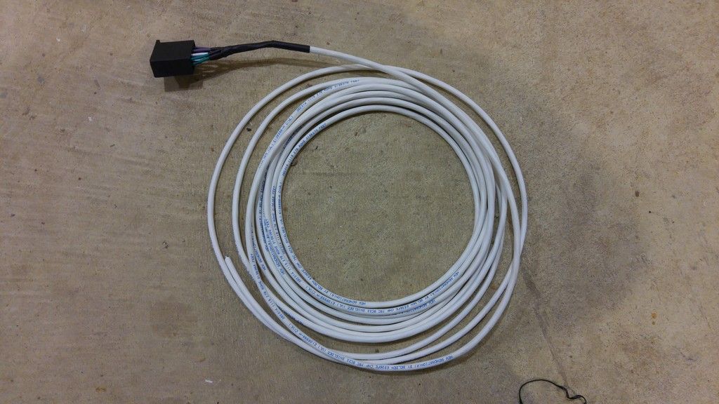

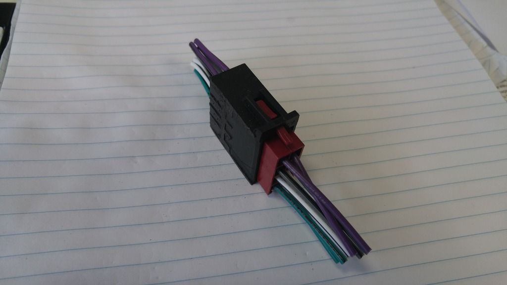

      I had some time tonight to prep the SOT-045 harness for subwoofer signal. Good thing that i kept the "extra" connectors that i cut off for the parrot system. They came in handy to build some quick disconnect harnesses for the sub woofer signal cable.
      after some hack saw action
      Subwoofer amp signal wire. I used a 8 conductor 22awg cable for this (some amps like the Alpine MRV-M250 utilize front and rear channel high level inputs)

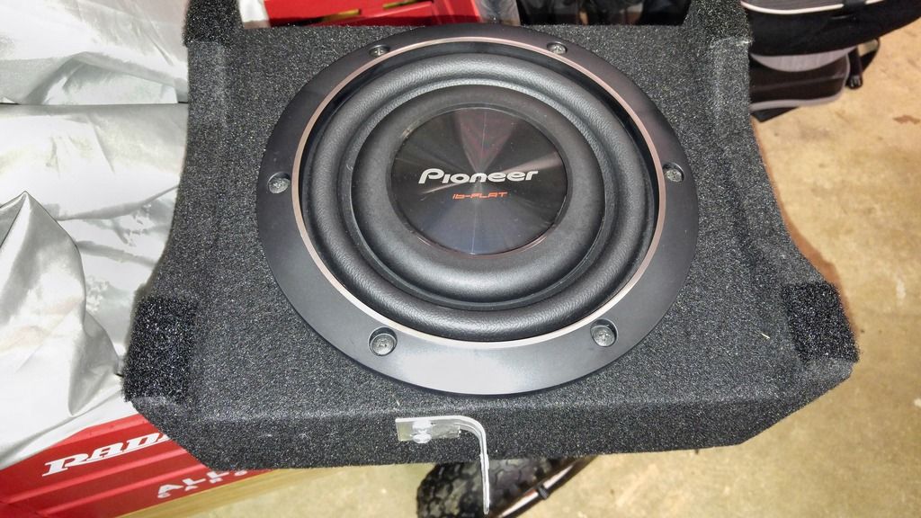

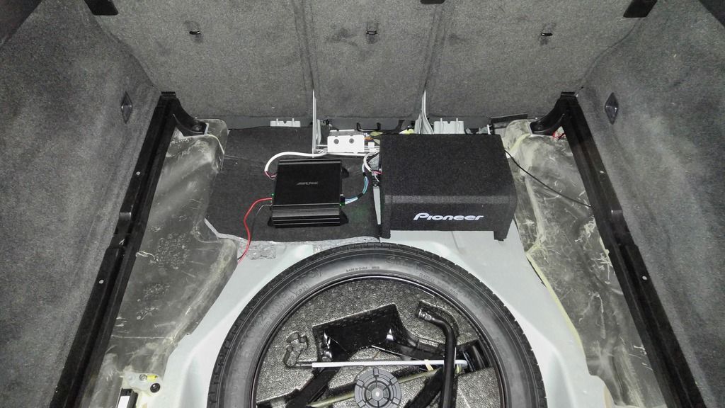

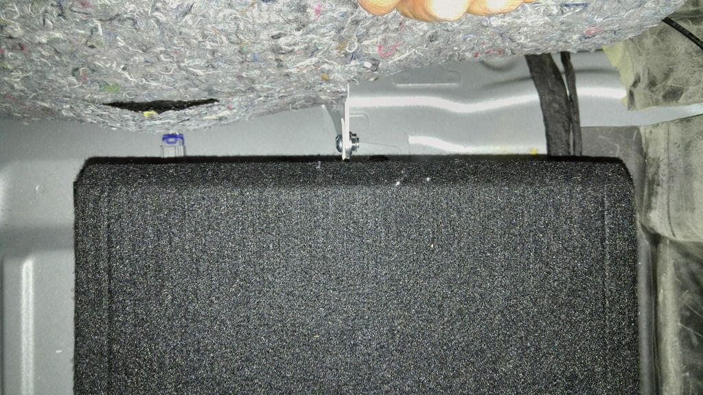

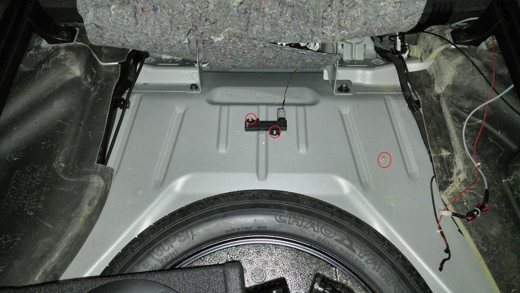

      Ok, so good news! Parts arrived. I have successfully installed the subwoofer about 95% complete, which means the box fits (i can definitely fit a second one)! Also, one of the more important things, the high level auto turn on is compatible with our factory amp! I also did some brief testing, but it was getting late to really blast any music. From what i've heard so far, i can say the subwoofer was a success. I have my crossover set to about 70hz to match my speakers, gain 1 click from "normal", bass boost off, and can now hear all sorts of low end that i did not have before. The bass is low, but nothing that's going to shake the car next to you. (i'll try to take a video tomorrow) Overall it is a huge improvement over the Sound ordnance B-8PTD slim powered subwoofer i had installed previously and i'm very happy with the fact that it's a drop in system that took no modification. Now onto the pictures!
      The goods! Not pictured is the poly fill. I originally stuffed the box with about 2.5oz of that stuff and took a little bit out because you don't want to compact it into the box. It should be fluffy.
      I'm sure all xc60's have these studs. There are 3 of them which you have to manuever around or you can dremel them off. I decided to leave them as they do not interfere with my subwoofer location, but i did move the key sense back to the recessed area right above it in the picture.
      I decided to stick with not modifying any part of the car so i copied mark-sf's idea and used some velcro on the legs and installed a L bracket to utilize the pre drilled hole on the seat bracket.
      Here is a picture of the 90 degree bracket bolted to the seat bracket
      Here is the install. I still need a more permanent location for the amp. I ran out of time tonight as i only have a few hours for my projects after my daughter goes to bed everynight.
      Whats left? I need to find a more permanent amp location/mounting mechanism as it's currently velcro'd to sound deadning and will probably cut up the organizer tray.
      2015 XC60 RD | eibach springs | snabb intake | TDI tune | Niche 21x10 wheels
