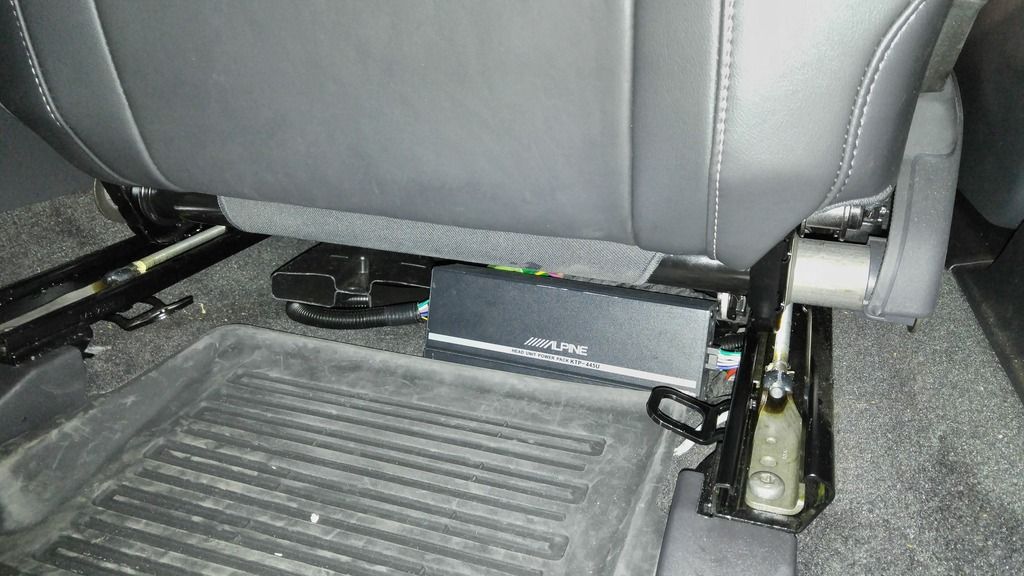

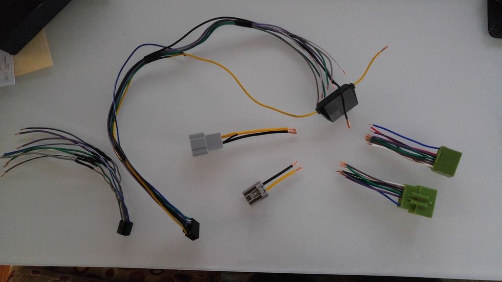

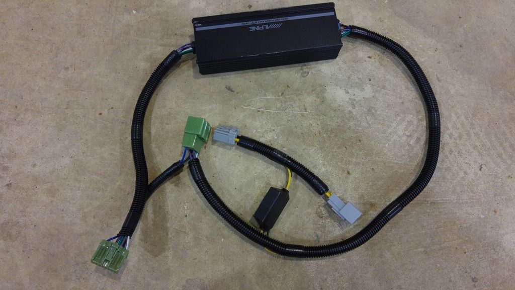

      Quote Originally Posted by bhom920 View Post
      I had some time this afternoon to install the Alpine power pack. The SOT-045 harness made the wiring super easy, i can say that this was the easiest amp that i've installed. None of the factory wiring was touched, I was also able to use the built in speaker sensing function of the amp so that i did not need a remote turn on wire. The hardest part of the install was placing the new amp. I wanted to keep it right behind the factory amp like another member did on this forum, but the mess of harness and extra wire was a little bit of a pain to tuck in the right places. A quick tip: Be careful of the fiber wires located on the right side of the oem amp (they are orange). My amp is not mounted, it just happened to wedge perfectly in the space. See pics below of the installation:
      De-pinning of any "extra wires"
      All of the harnesses prepped and ready for soldering
      The finished plug and play harness
      Amp installed. This picture was taken with the seat all the way forward.
      Overall impressions from a quick drive:
      I'm not a audiophile or a audio expert, but the mids and highs are much more brought out from the headphones for guitar AMP. Bass seems to remain about the same which could just be a driver limit or acoustical limit of the door. I was listening to some electronic, pop, and rap when i did this quick test. So far i'm very happy with what i hear. This amp upgrade might just be the small bump that most will need to be very happy with the factory high performance speakers. Stay tuned for the speaker upgrades next week.
