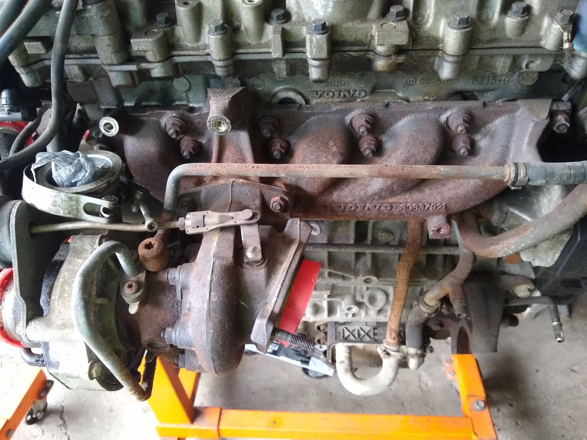

      Since I'm currently in a holding pattern waiting on wiring bits, I worked on buttoning up the bottom of the engine today.
      Got the new pick-up installed.
      Then I got the RN pan in place, along with a new filter.
      Next I bolted the oil cooler up and reinstalled the oil level sensor.
      Since there is no wiring connection on my car for the sensor, I got a few dimensions and will probably come up with a blank-off plate for that in the future.
      The Volvo oil cooler hoses are in good shape, so I can reuse those.
      I flipped the engine back over and removed the N water pipe in prep for the proper RN one for my set up and did a little more cleaning.
