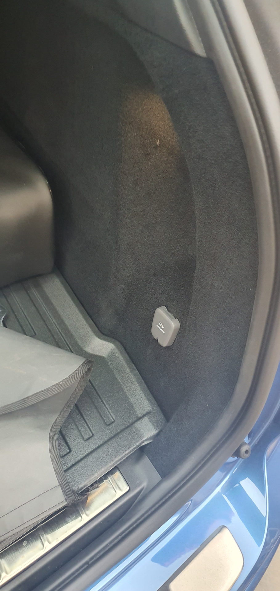

just in case anyone also missed a plug...

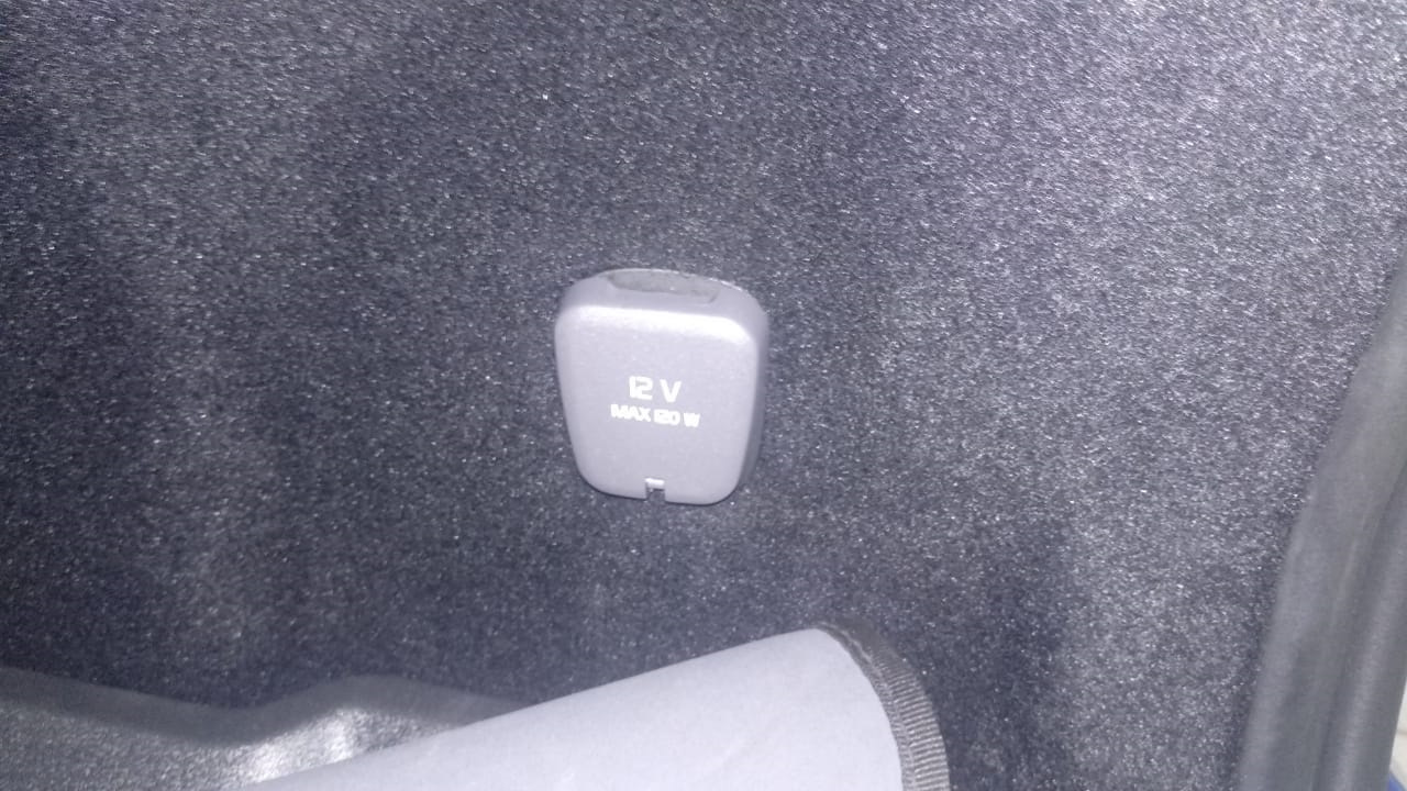

Decided to add it, and first idea was to add it to common place, hoping that wiring is in place, even if no plug from factory.
This assumption was wrong.. and no wiring exist.
So after a bit of conversion with dealer, decided to change the place, not drilling left cover, but use existing one on right side (supposed for foldable towbar button), using existing wring and add fuse on 25A.
Used these parts 31324708 (plug) + 30653376 (holding ring).
Result below (and it powered in always mode, although I am going to use it always, only when needed):

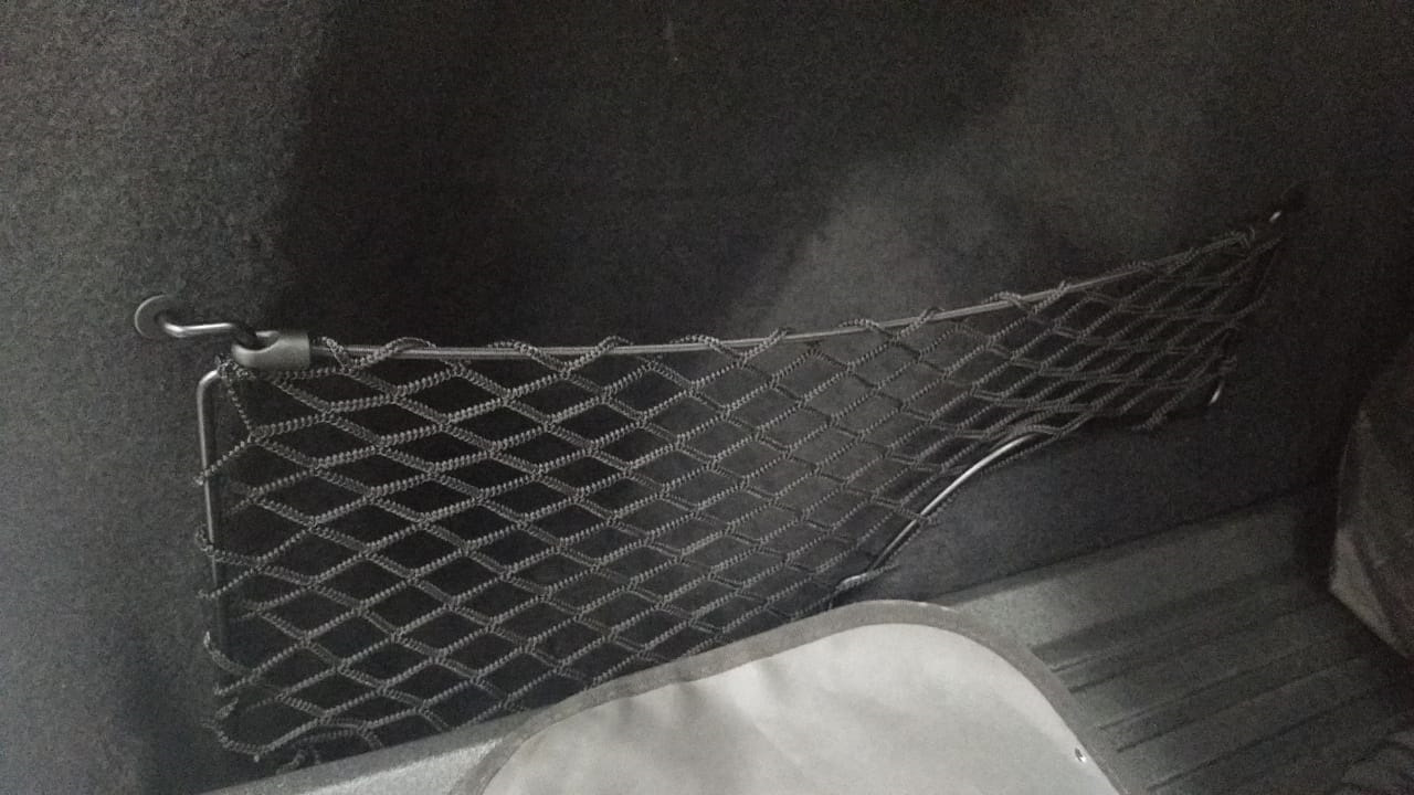

And also added net as well (net part number 31484109 + clips 31675675- 2pcs, 31675676 - 2 pcs)
