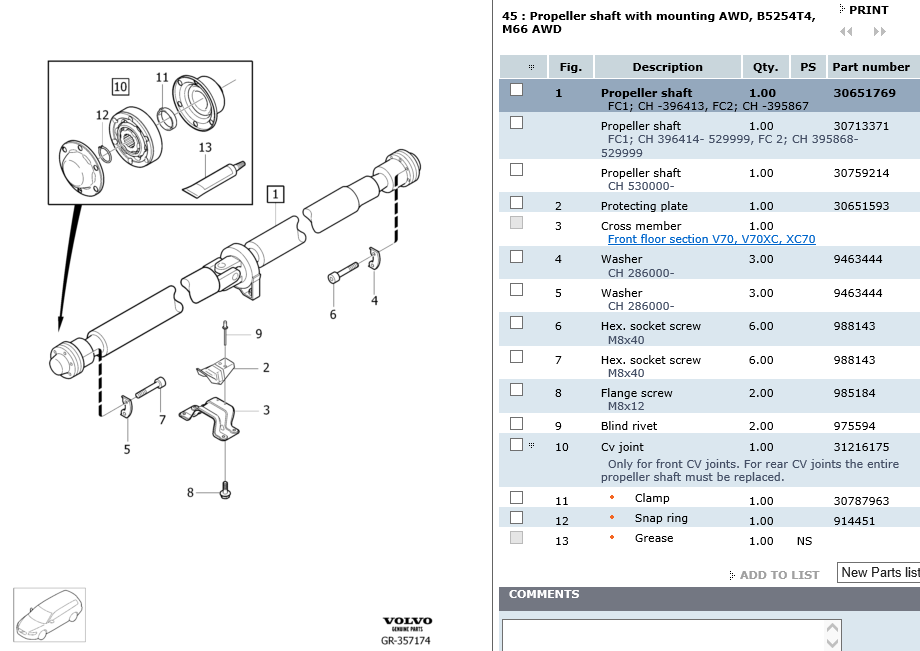

      Joint in between the angle gear and the driveshaft appears to have been leaking for some time. Is this sort of leakage normal, or should it be dry?
      I've been getting an audible noise in the cabin which is approximately from the area of this coupling though it's hard to be exactly certain. I've been suspecting either this joint or the angle gear, and well, here we are. I was only just able to catch audio of it in the cabin this week, any other time I've tried it's washed out in road noise. Have a listen, it's sort of a whirring noise that can be heard when the drivetrain is loaded, either accelerating or decelerating. The noise goes away when just going on or off the gas as backlash is taken up in the system changing the load direction. Also goes away when the clutch is in or coasting in neutral, so it's something in the drivetrain, not a wheel bearing or anything like that.
      Anyone agree or disagree to this being the cause? Tips on replacement for this joint?

      Problem 3: Looks like a minor leak but I don't know if I'd ignore it either. See what others say.
      Yeah, wondering what others have to say on this too. I think it's been developing for some months, maybe 6+. I don't expect there's a whole lot of grease in that space, so once a bit leaves...
      Anyone service this joint before? Tips? The VIDA instructions don't look particularly fun, but doable. I'd likely need parts 10 through 13 from the below diagram.
