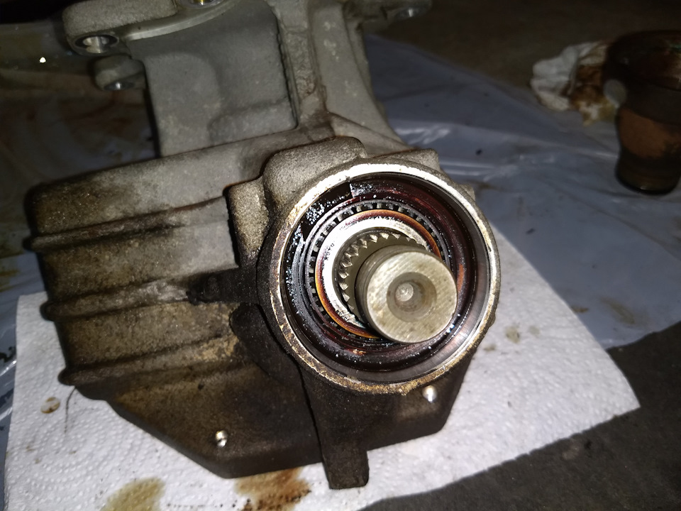

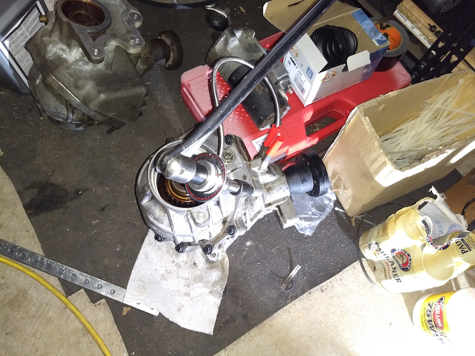

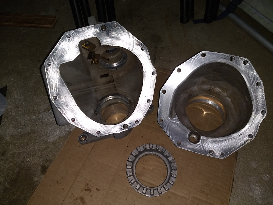

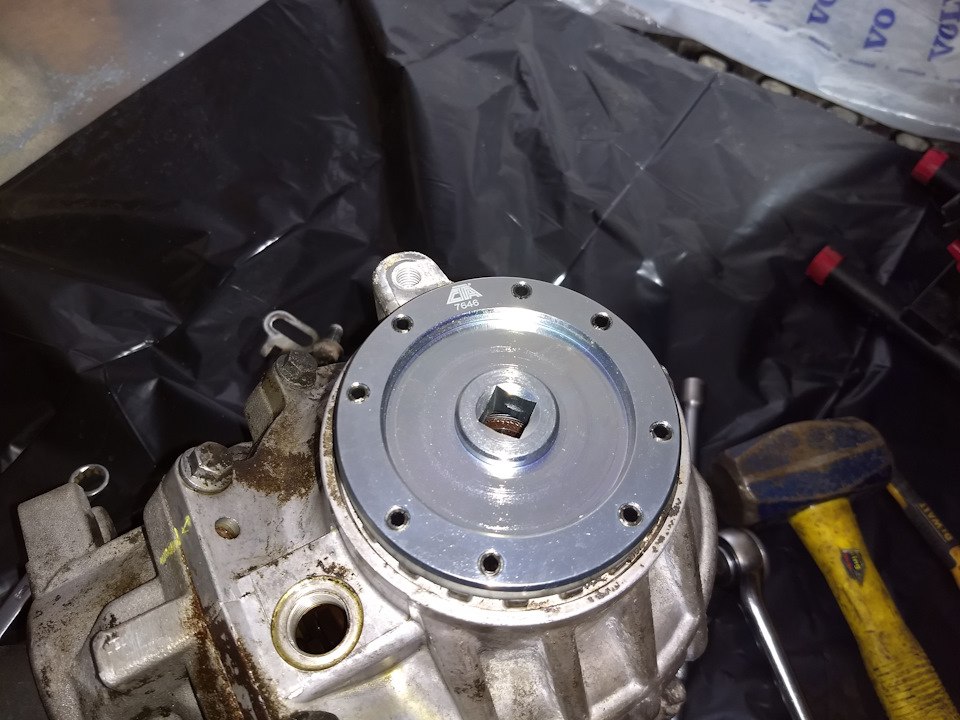

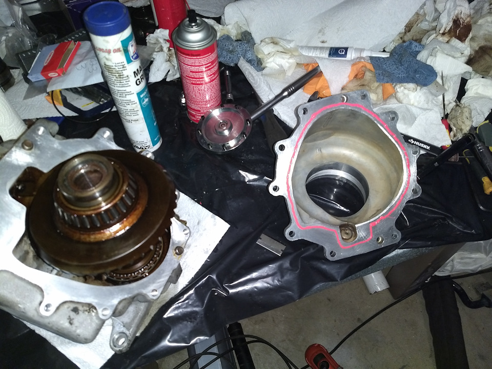

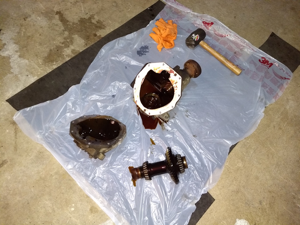

      Resealing new to me AG I've got from ErieVovo: It had good splines, so I decided to keep it and reseal myself.
      You need this CTA tool:
      Buy Volvo or Permatex pink sealant:
      And angle protractor for torque-to-yield bolts (buy new):
      I took one shaft and both bearings out for clean/file/seals job. After putting everything back, the preload nut was one tooth off. If I move it in a marked position, the bearings were overtighten, so I decided to let it slack and tighten later if AG will start to howl.
      Another one. Here I tried to refurb input shaft in EU and replace all the bearing, the EU customs decided to tax repair guy for $300 since apparently you can't get junk part from USA.
      I would not recommend replacing this seal unless it's leaking. If you decide to touch it, the AG would need a new crush sleeve and a proper bearing preloading - not quite impossible to do in garage, but mistake is easy to do, and that would cost you AG.
      Otherwise, replaces 3 input shafts seals and O-ring while you are there. Plus new breather/filter.
      Also test/feel input shaft splines with a small screwdriver along the full length. If you feel any notches - replace the AG, it will chew up itself and collar sleeves, and will finally strip, like mine did. Not worth resealing it.
      While the AG is split in halves, you may want to drill the lowest bolt through, so the AG will have a drain plug now. Use caution not to damage the threads. Add copper washer to the bolt and apply liberal amount of sealant, on the threads-free part.

      You should be able to handle it. Just be sure to use the correct sealant. You can use anaerobic, but don't bother beveling the edge and make sure to apply it correctly (roll on, not a bead). I wouldn't though, as that's the original sealant which failed and caused Volvo to issue to updated procedure in the first place.
      Without the special tool, you'll have to get creative to install the input shaft seal. DIYers probably install it before putting the case together. I'd also suggest replacing the input shaft sleeve and thoroughly greasing it with the proper grease.

      I just resealed my AG on my Ď05 SR. It was a rushed job and I wasnít too happy about that. I used standard gear box RTV, and didnít bevel the case. And because of the rushed nature of the work, didnít replace all the seals. Luckily the leaking seals were at the ring gear preload adjustment - the crown ring , so they were easy to get to.
      I had previously taken the car to a shop to have a new collar installed (among other things) and found when doing this job that they hadnít installed the top bolt. I was pretty disappointed given their reputation.
      The splines on my input shaft didnít look great (you canít strip a collar and not do at least some damage to the AG input), so Iíll probably spice a better one and do a full reseal at some point.
      For the crown ring removal, I had a 2í length of 1/4Ēx2Ē mild steel lying around that fit nicely in the crown portion and gave me nice leverage.
      You probably already know this, but use a center punch or something similar to mark the location of the crown ring and donít forget to COUNT the number of turns when taking it off. Thats if youíre not replacing the bearings.

      Hereís what Iím up against.

      Yeah, this is pain... Use new bolts VIDA says.
      Also, collar sleeve looks almost stripped. The splines on the AG shaft are bad too, most certainly.

      Angle Gear Resealing
      Alright, hereís the update. Bottom hole is perfectly centred drilled and ready for re-tapping. Check.
      Top bolt is drilled through but the hole is off centre I guess because my perspective was off when I started. Crap. Any ideas on best course of action for this one. Iím afraid that I I keep drilling that the hole is just going to start cutting into the softer aluminum and put things off centre. I have no faith in extractors and really donít want to break one and be back to square one.

      I just went through this with my S60R. You may be able eat away at the larger portion with a Dremel. I ended up having to drill and tap it a size bigger.
