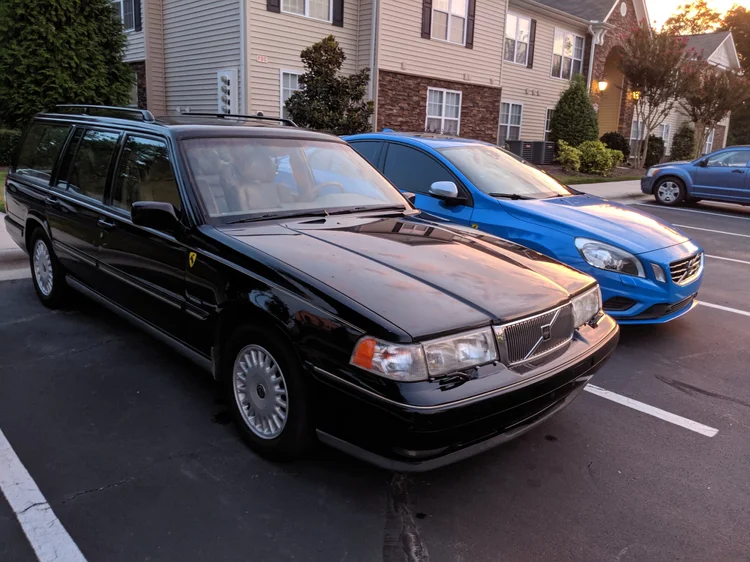

      So this is the $800 Volvo 960 I picked up back in September, I figured I would post my updates that I usually put on my website on here as well, maybe generate some more traffic to the 960 board here since they are pretty competent cars and the very last of the RWD Volvos.
      The body is in pretty good condition, but its definitely a little rough around the edges. The car itself has over 190k on the clock, and all of its history up to this point is a mystery to me. Surprisingly I am only the 3rd owner of the car, and I intend, or at least hope to, get the car back into a running / driving condition.
      While I was able to drive the car home, it definitely needs a lot of work before I would consider actually driving it anywhere. As it stands it needs (in no particular order):

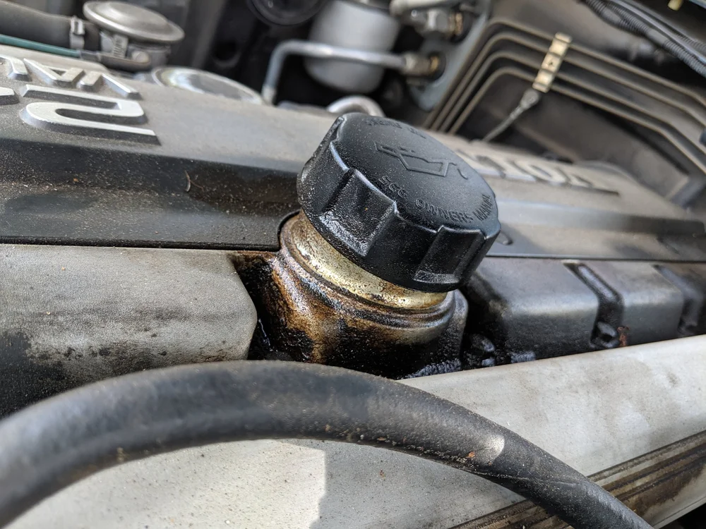

      The gasket of the oil cap can go bad on the 6cyl motor, leading to oil build up around the cap and pooling along areas of the head. The oil from the cap has been leaking significantly, there is buildup around the intake and even the throttle body.

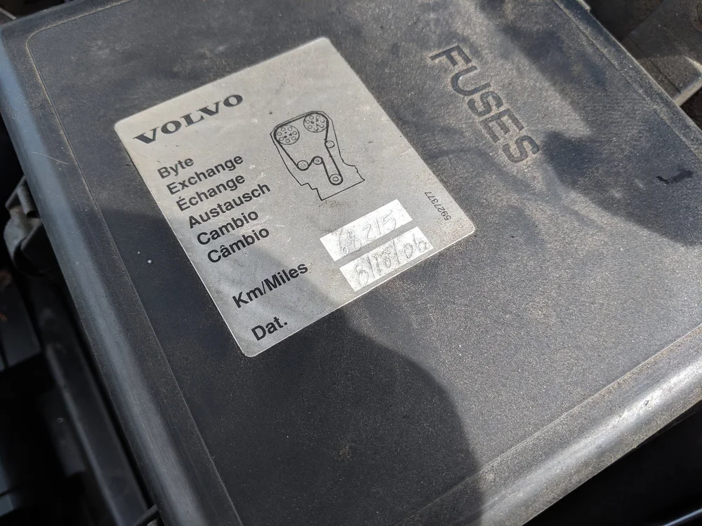

      Additionally, while I was in the engine bay I made sure to check the belts. The motor on the 960 series cars use an interference design, meaning that the timing belt is crucial to the operation of the engine. Without the belt, the pistons will rise on the combustion stroke and collide with the stuck open valves since the belt controls when the valves open and close. Unfortunately, the sticker for the last timing belt replacement on this car dates back to 2006 when the car had significantly less miles. I assume that it has been replaced since then since the service interval for the belt is around 40-50k miles.
      Not the information you want to see on a car in 2019 with 190k miles on the ODO.
      While the timing belt may not look terrible upon my brief inspection, I would HIGHLY recommend that any new 960 owner do the maintenance on it. I plan on using IPDs kit with a new belt, pulleys, and tensioner as any of these components going bad can cause a catastrophic failure of the motor.

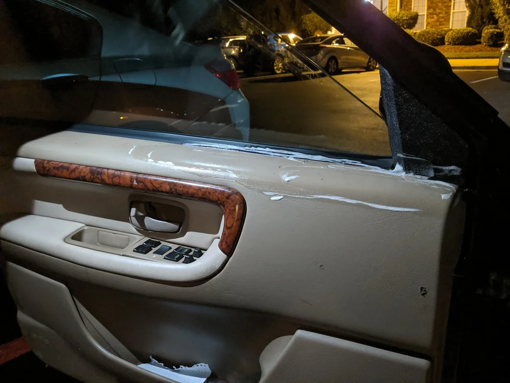

      In addition to the many small mechanical repairs I have made on the car, I was able to recruit my long time friend, and former 850R co-owner Steve to help me with really giving the car a good cosmetic make over. If I am being honest, the car will never be perfect, because at the end of the day its still a 22 year old Volvo that I bought for $800. We were able to rent a wet vacuum from Home Depot, as well as pick up a few heavy duty cleaners and de-greasers to really give the interior of the car a good makeover. Most of the work was done at night, but I can attest to the fact that Steves elbow grease on the door cars and carpet made a huge difference in removing the smokey, stale smell from the car.
      A mixture of Simple Green and a Magic Eraser being used to remove the built up tar and grime from each door card. Note all the cigarette burn holes…
