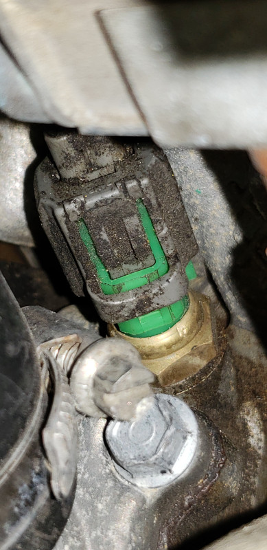

      I couldn't find any sings of the wires being pinched between the sensor and the wiring harness under the plastic injector cover.
      Wiring/Sensor:

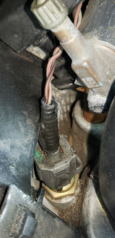

      You think the green plug color is an indicator of a non-OEM part? I've read several places that aftermarket ECT's can be problematic.
      I can't find any photos of a Volvo/OEM sensor plastic plug being green. It looks to me like perhaps the housing was replaced with a Dorman unit:
      The Borg Warner is gray:
      And the Volvo ECT is black:
